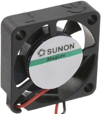

    Tanner MetzmeierT Tanner Metzmeier
    I have the Voxl2 in an enclosure and it appears to be suffering from thermal throttling when the CPU hits 95 degrees. Is there a heat sink that Modal recommends for the Voxl2, I could only find this fan in your products:
    https://www.modalai.com/products/voxl-cooling-fan?_pos=15&_sid=fb4d90556&_ss=r
    The RB5 development kit includes a thermal plate and an optional heat sink + fan can be purchased from Thundercomm:
    https://www.thundercomm.com/product/heatsink-with-fan/
    Is there anything planned like this for the Voxl2?
