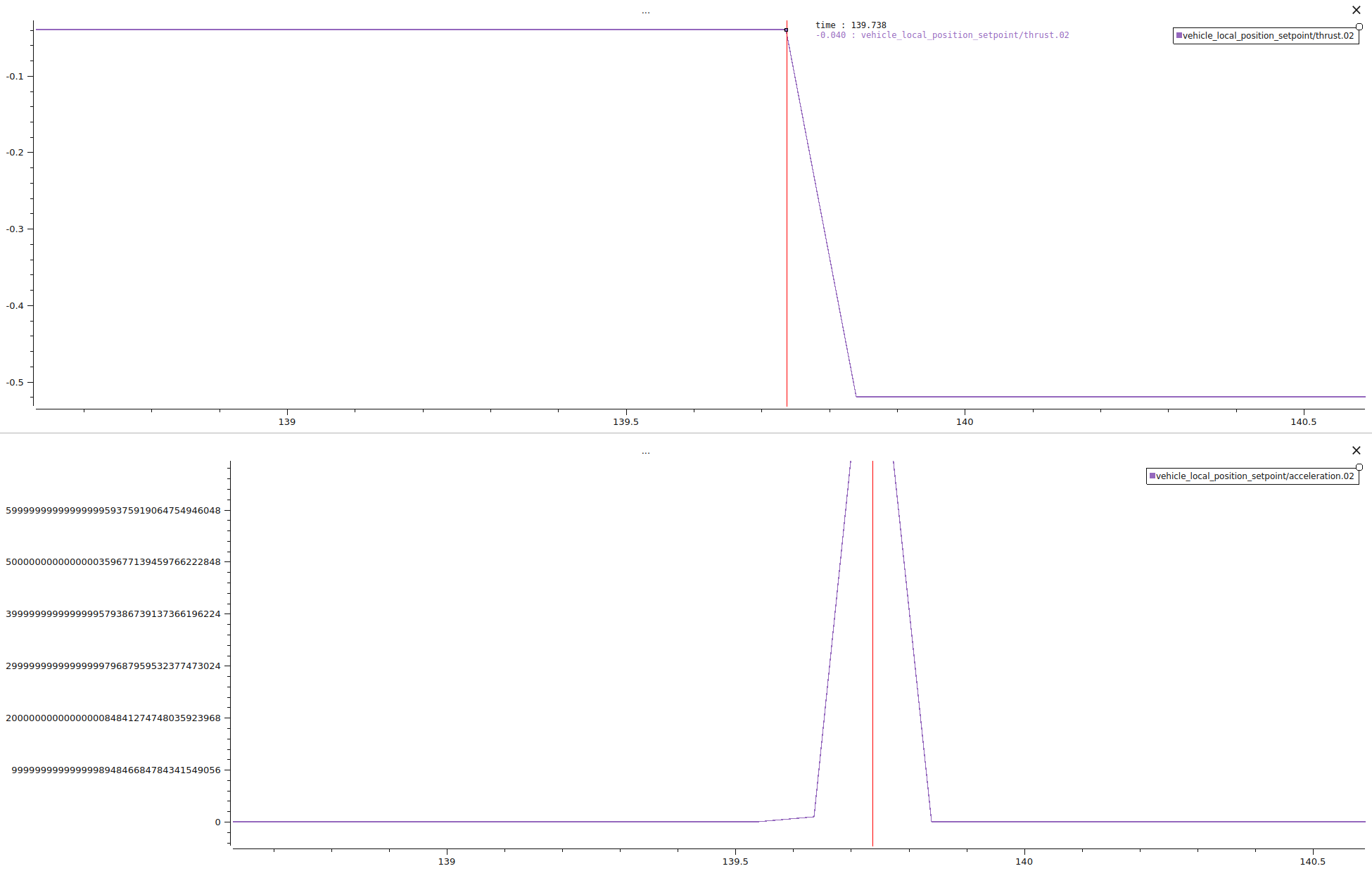

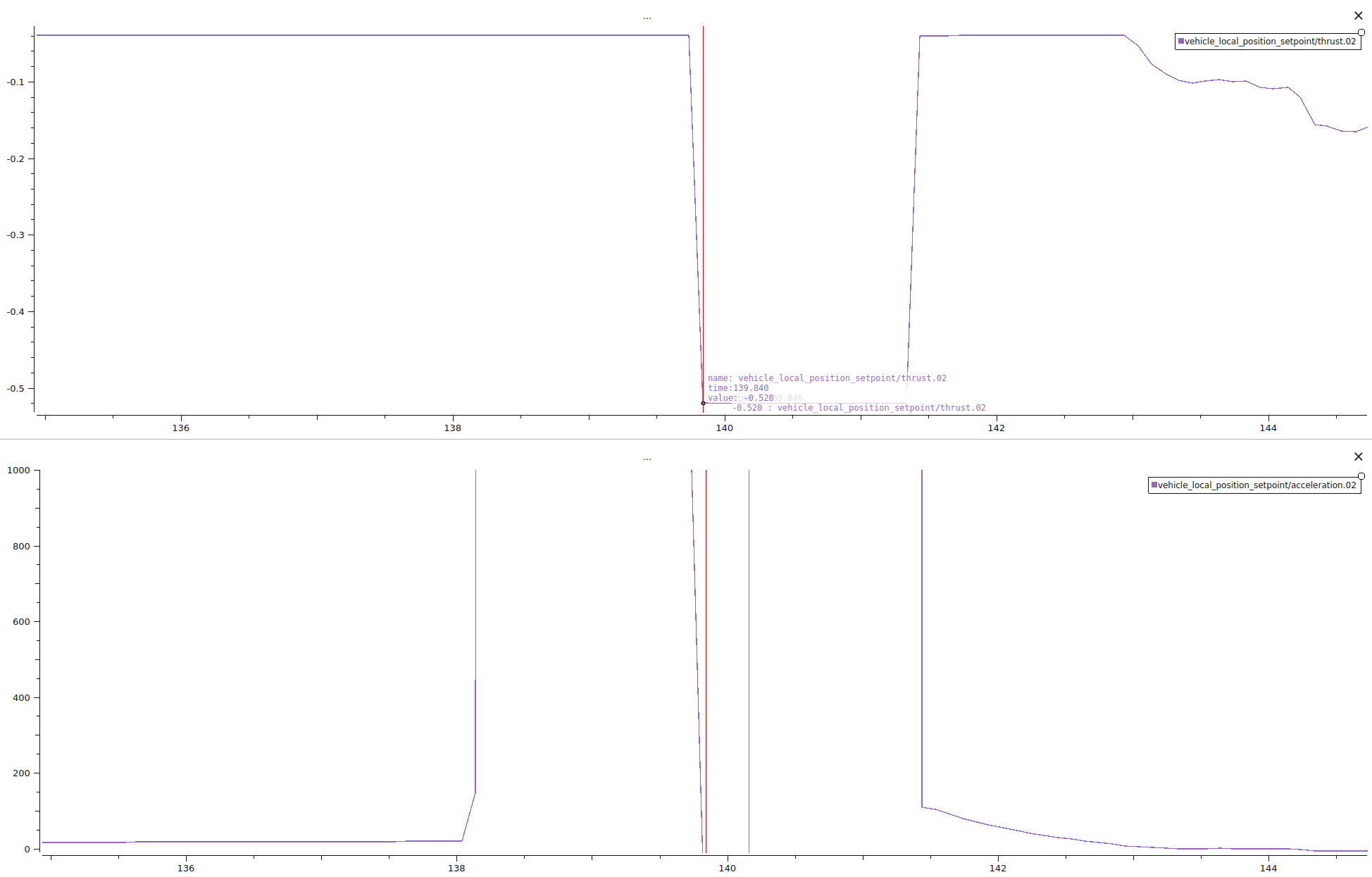

      We noticed in the logs that the vehicle_local_position_setpoint/acceleration value increases from about 20 to a number so large it causes a floating-point overload, causing the acceleration to go negative.
      At the point where the value goes negative, the propellers spin up full speed, and the drone jumps 15 meters.
      The increase in value took place over about a second.

      138.0s into the flight, the acceleration setpoint starts increasing rapidly.
      At 139.7 seconds into the flight, the thrust starts increasing, which coincides with the acceleration setpoint overloading and flipping sign.
      The event ends at about 141.5s into the flight, by that the time the drone is almost 15m into the air.
      We do not know the root cause of the acceleration spike.
