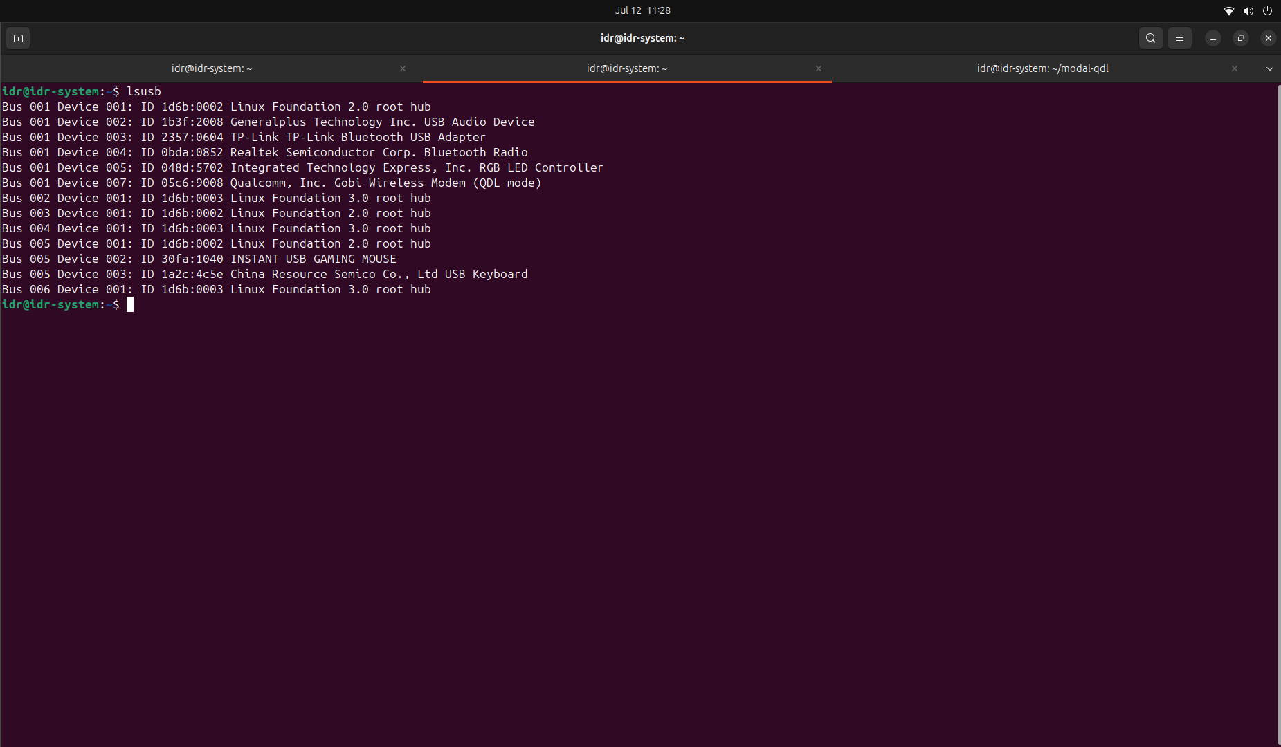

      • When I turn ON the SW2 switch, the device shows up in QDL mode in the lsusb output.

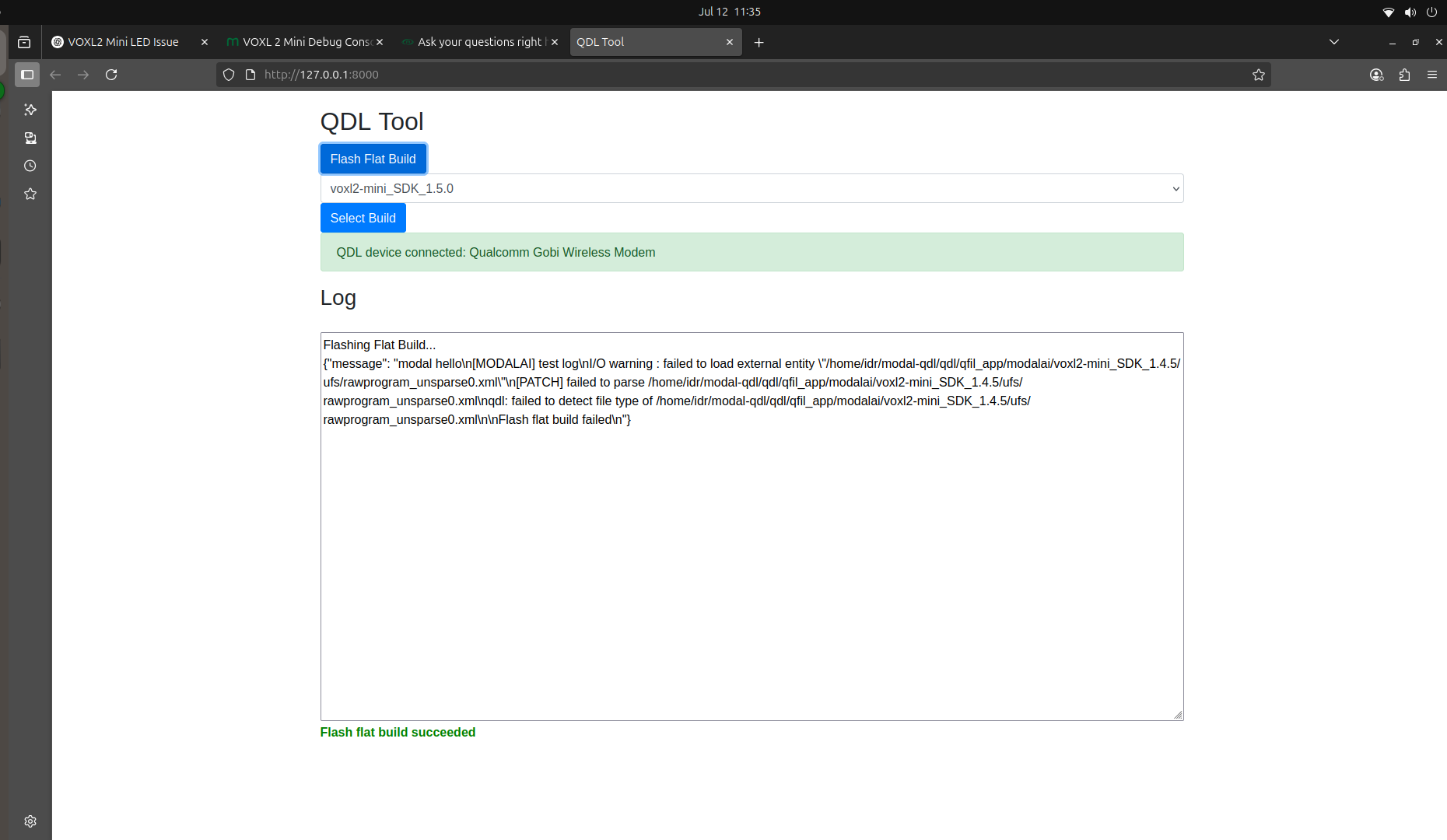

      • At this point, I attempted to reflash the image using the Flash Flat Build method, but the process failed (see attached screenshots).

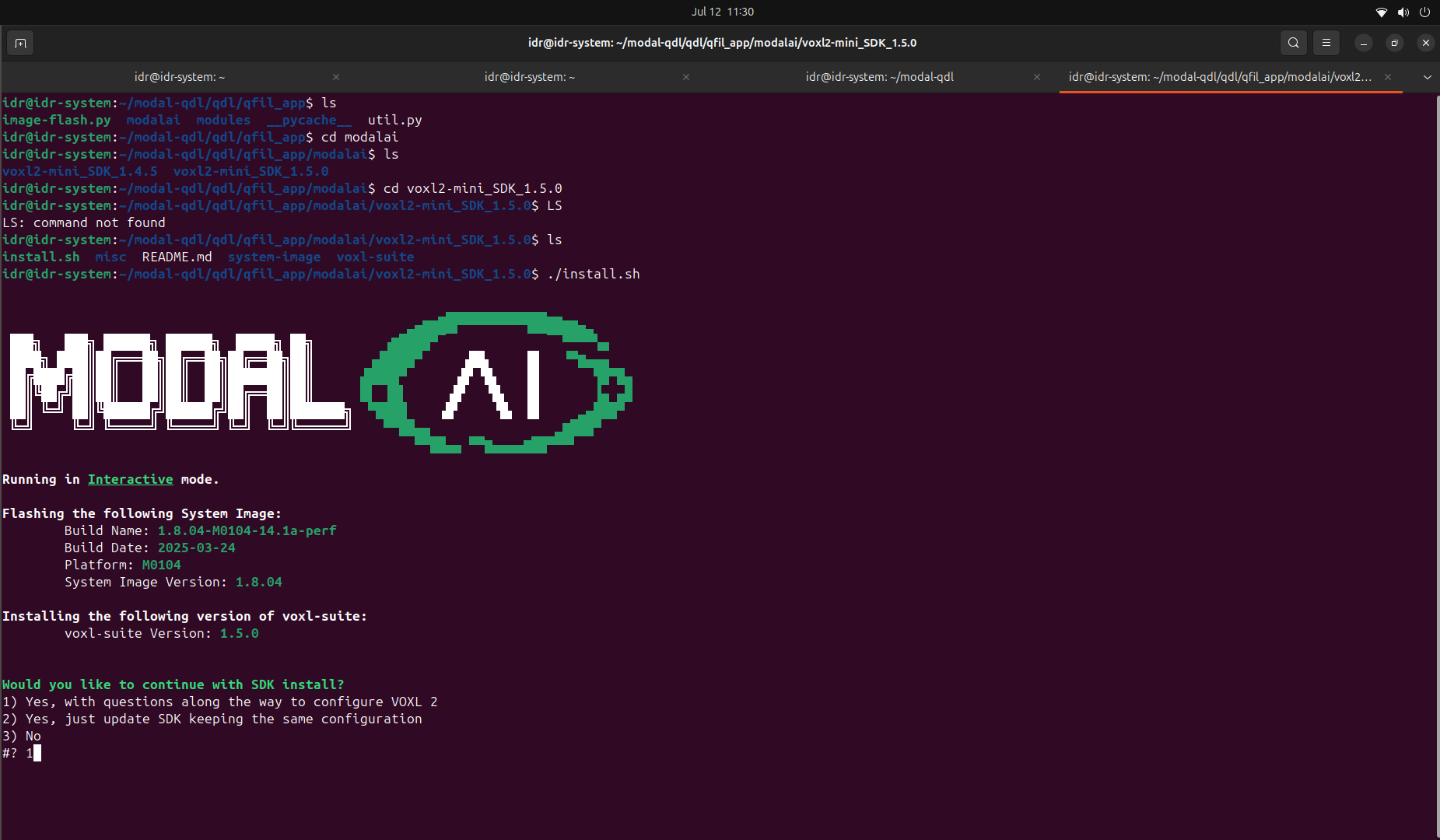

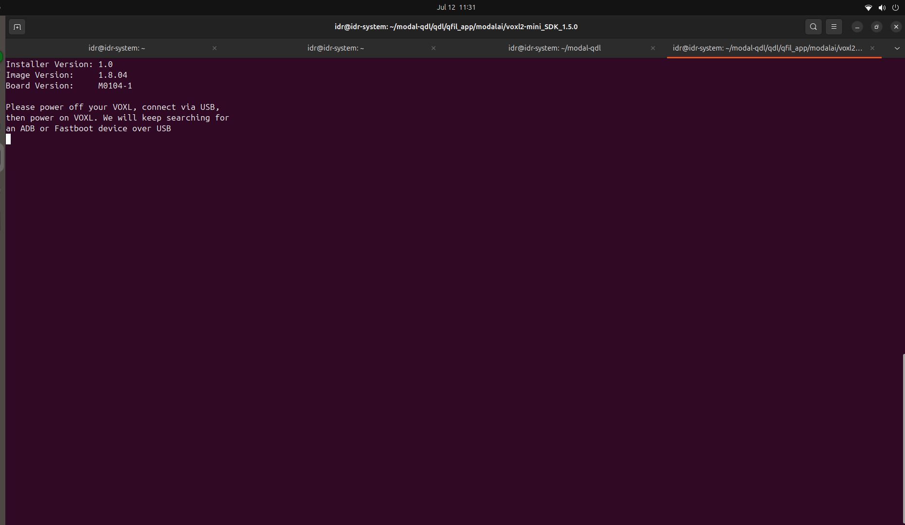

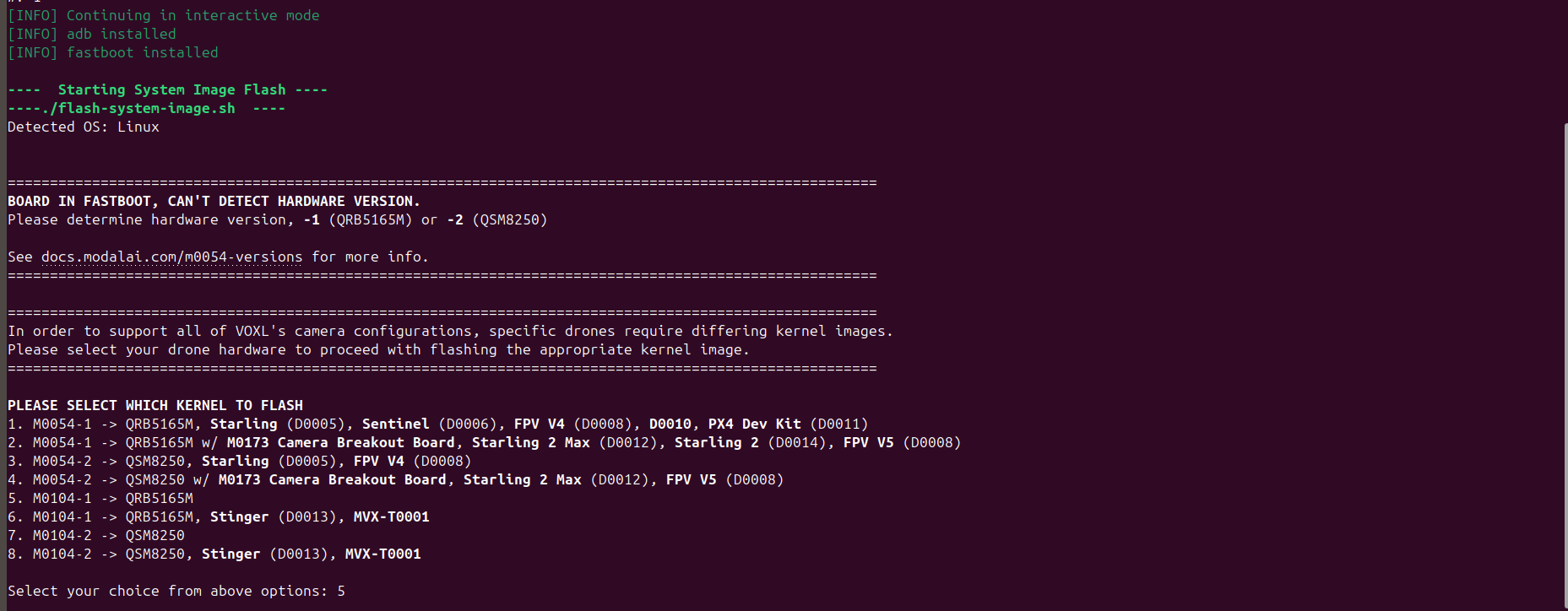

      • I also tried using the install.sh script to flash the image, but it couldn’t detect the VOXL2 Mini—neither through adb nor fastboot.

      • Nothing is detected in lsusb.
      • However, after 7–8 minutes, the DS2 LED turns on, and now the device appears in QDL mode in lsusb—even though SW2 remains OFF.

          check the folder inside qdl/qfill_app/modalai/voxl2-mini_SDK......
          Make sure that the ufc folder is present inside (occasionally after downloading the Flat Build and unzipping there might be voxl2-mini_SDL/voxl-2_mini_SDK). Make sure the path is qdl/qfill_app/modalai/voxl2-mini_SDK....../ufs
          Edit: Also, you have the wrong download for the flat build. You are currently using the SDK instead of the flat build file. We will send you the correct link to the folder in a few minutes
