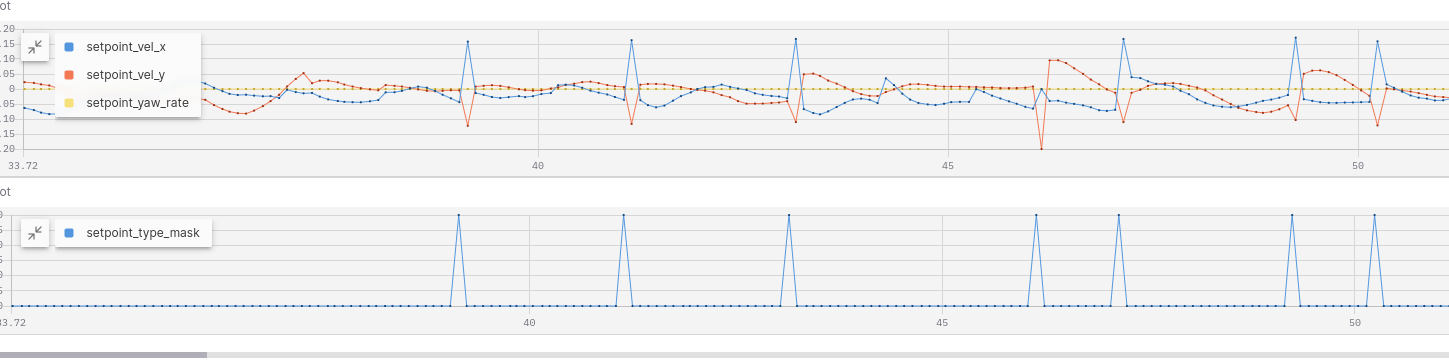

      I use pymavlink to listen to the mavlink messages:
      connection = mavutil.mavlink_connection('udpin:127.0.0.1:14551')
      Below are my recordings of POSITION_TARGET_LOCAL_NED mavlink msg (@10Hz)
      I would expect the setpoint values to remain constant until a new value is sent from voxl-planner (like it is with the x,y,z,yaw setpoint command)
      Any thoughts?
      Thank you

        From investigating the voxl-vision-hub code with added prints for debug, I see that the setpoint SETPOINT_POSITION_MAGIC_NUMBER is sent to mavlink-server from two functions -
        (1) _send_current_position()
        sending the current position, and type-mask ignoring vx,vy,vz,ax,ay,az,yaw_rate
        // fetch latest position and attitude from px4 itself so the setpoint
        // we are about to send is a close as possible to where we currently are
        (2) execute_setpoint_position_command()
        sending the setpoint as recieved from voxl-planner
        The implemented behaviour of (1) suits the situation of position+yaw command. However for vx+vy+z+yaw_rate command I think something is missing.
        Any help will be appreciated.
