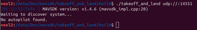

      I am trying to run the takeoff_and_land example (v 1.4.6)Screenshot from 2025-05-08 12-31-12.png I get an error saying no autopilot found. I checked and I have onboard heartbeat and I reset voxl-mavlink-server and voxl-vision-hub to factory settings and set:
      "en_localhost_mavlink_udp": true,
      "localhost_udp_port_number": 14551,

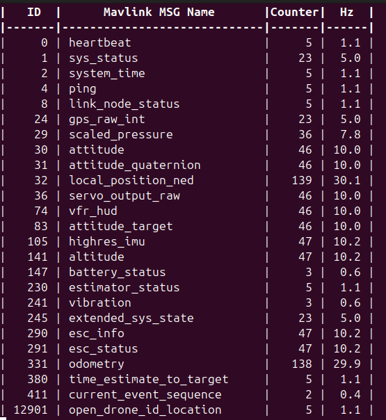

      I also checked and I have onboard heartbeat:

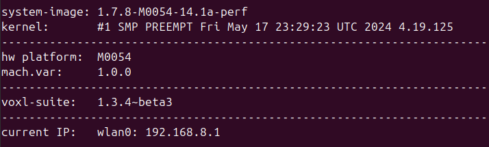

      System: VOXL 2
