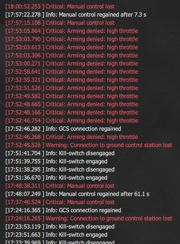

Regarding Channels 5–8 need to be swept during calibration, one of the steps ask for both joystick to be in certain position and left and right top button. In that case, do I press/toggle channel 5-8 all at once or one after another. The instructions were not clear, so I believe that may have caused the calibration at bad state as you mentioned. Would you mind provide steps particularly for channel 5-8 for Ghost RC.<br />
Also, are you available over the phone tomorrow if support needed.</p>
<p dir="auto">It looks like arming denied due to high throttle. I had throttle pulled all the way down and to the right for arming propeller as that is how it used to arm prior calibration.</p>
<p dir="auto"><img src="/assets/uploads/files/1791431588497-42eafe2d-3ec6-4c5e-ae80-600e66a8b142-image.jpeg" alt="42eafe2d-3ec6-4c5e-ae80-600e66a8b142-image.jpeg" class=" img-fluid img-markdown" /></p>

<p dir="auto"><strong>Step 2: Re-check RC calibration (switch channels)</strong></p>
<p dir="auto">If the protocol is correct, the calibration itself may have missed the switch channels. When you re-run RC calibration in QGroundControl, make sure you move <strong>all switches</strong> (kill switch, mode switch, and any others) through their full range when prompted. Channels 5–8 need to be swept or the calibration will leave them in a bad state.</p>
<p dir="auto"><strong>Step 3: Check the specific arming failure reason in QGC</strong></p>
<p dir="auto">Connect to QGroundControl and attempt to arm. QGC will display a specific pre-arm failure message (e.g., "RC not calibrated", "Throttle too high", "Kill switch engaged"). That message will tell you exactly what PX4 is blocking on.</p>
