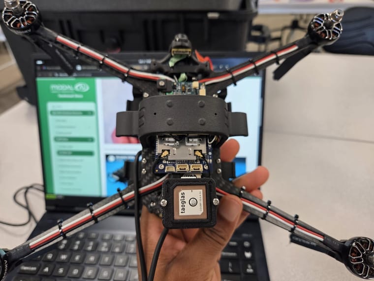

<?xml version="1.0" encoding="UTF-8"?><rss xmlns:dc="http://purl.org/dc/elements/1.1/" xmlns:content="http://purl.org/rss/1.0/modules/content/" xmlns:atom="http://www.w3.org/2005/Atom" version="2.0"><channel><title><![CDATA[Starling 2 max Not detecting Wifi hardware]]></title><description><![CDATA[<p dir="auto">I am setting up a new Starling 2 Max (SKU: MRB-D0012-4-V2-C28-T8-M11-X0) and am unable to configure Wi-Fi.</p>
<p dir="auto">The system reports:</p>
<p dir="auto">voxl-wifi getmode → Mode: undefined, Hardware: single-mode (None)</p>
<p dir="auto">voxl-my-ip only shows 192.168.168.100 (usb0)</p>
<p dir="auto">iw dev returns no wireless interfaces</p>
<p dir="auto">ip link shows no wlan0 or uap0</p>
<p dir="auto">ping 8.8.8.8 returns Network is unreachable</p>
<p dir="auto">I also verified that the Wi-Fi driver module exists and loads successfully:</p>
<p dir="auto">88XXau.ko is present under /lib/modules/4.19.125/</p>
<p dir="auto">modprobe 88XXau loads without errors</p>
<p dir="auto">lsmod shows 88XXau loaded</p>
<p dir="auto">However, no wireless interface appears after loading the driver. This Starling was taken directly out of the box and has not been modified.</p>
<p dir="auto">System information:</p>
<p dir="auto">System Image: 1.8.06-M0054-14.1a-perf</p>
<p dir="auto">VOXL Suite: 1.6.3</p>
<p dir="auto">Hardware Platform: M0054</p>
<p dir="auto">Kernel: 4.19.125</p>
<p dir="auto">Could you please advise whether additional configuration is required or if there may be an issue with the Wi-Fi hardware or image installation?</p>

]]></description><link>https://forum.modalai.com/post/26041</link><guid isPermaLink="true">https://forum.modalai.com/post/26041</guid><dc:creator><![CDATA[Alex Kushleyev]]></dc:creator><pubDate>Fri, 05 Jun 2026 17:58:50 GMT</pubDate></item></channel></rss>
