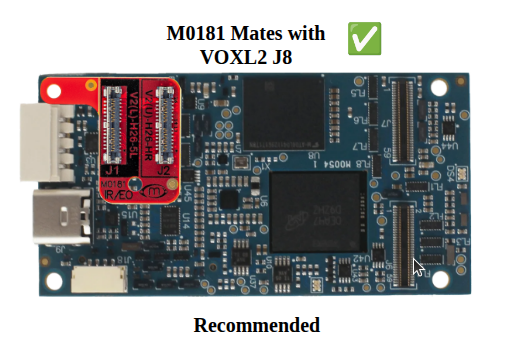

<p dir="auto">Then if we use J8U (which can be done using M0181 - it allows you to connect a Boson sensor to lower slot, and a tracking / hires camera to upper slot). Then the fourth camera would be:</p>
<pre><code>VOXL2 J8: M0181 Upper : AR0144 slot 5 : CCI3
</code></pre>
<p dir="auto">And there are no CCI conflicts.</p>

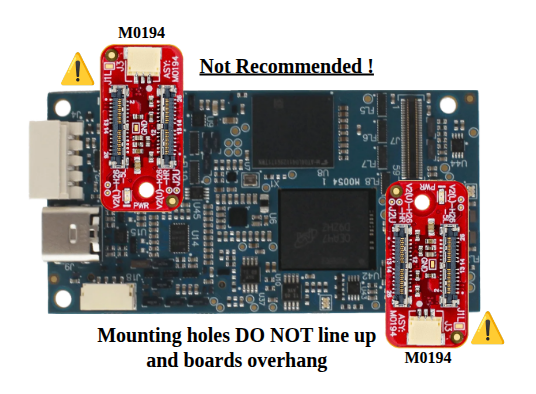

<p dir="auto">One issue is that we don't typically sell M0181 by itself (only in a kit). Instead you could use two other options, both of which allow connecting a tracking / hires camera to the upper slot:</p>
<ul>
<li>M0194 : <a href="https://www.modalai.com/products/m0194/" rel="nofollow ugc">https://www.modalai.com/products/m0194/</a></li>
<li>M0172: <a href="https://docs.modalai.com/M0172/" rel="nofollow ugc">https://docs.modalai.com/M0172/</a> / <a href="https://www.modalai.com/products/mdk-m0172-1-00" rel="nofollow ugc">https://www.modalai.com/products/mdk-m0172-1-00</a></li>
</ul>
<p dir="auto">The only down side of using M0172 / M0194 instead of M0181 is that the two alternatives do not have a mounting hole that would align with VOXL2 mounting hole, but M0181 does have a tab with a mounting hole for VOXL2 J8, see below. The M0172 and M0194 were really designed as mainly options for VOXL2 mini.</p>
<p dir="auto"><img src="/assets/uploads/files/1780458131518-98d5f0ec-7f07-44bf-b002-036aefd3921d-image.png" alt="98d5f0ec-7f07-44bf-b002-036aefd3921d-image.png" class=" img-fluid img-markdown" /></p>
